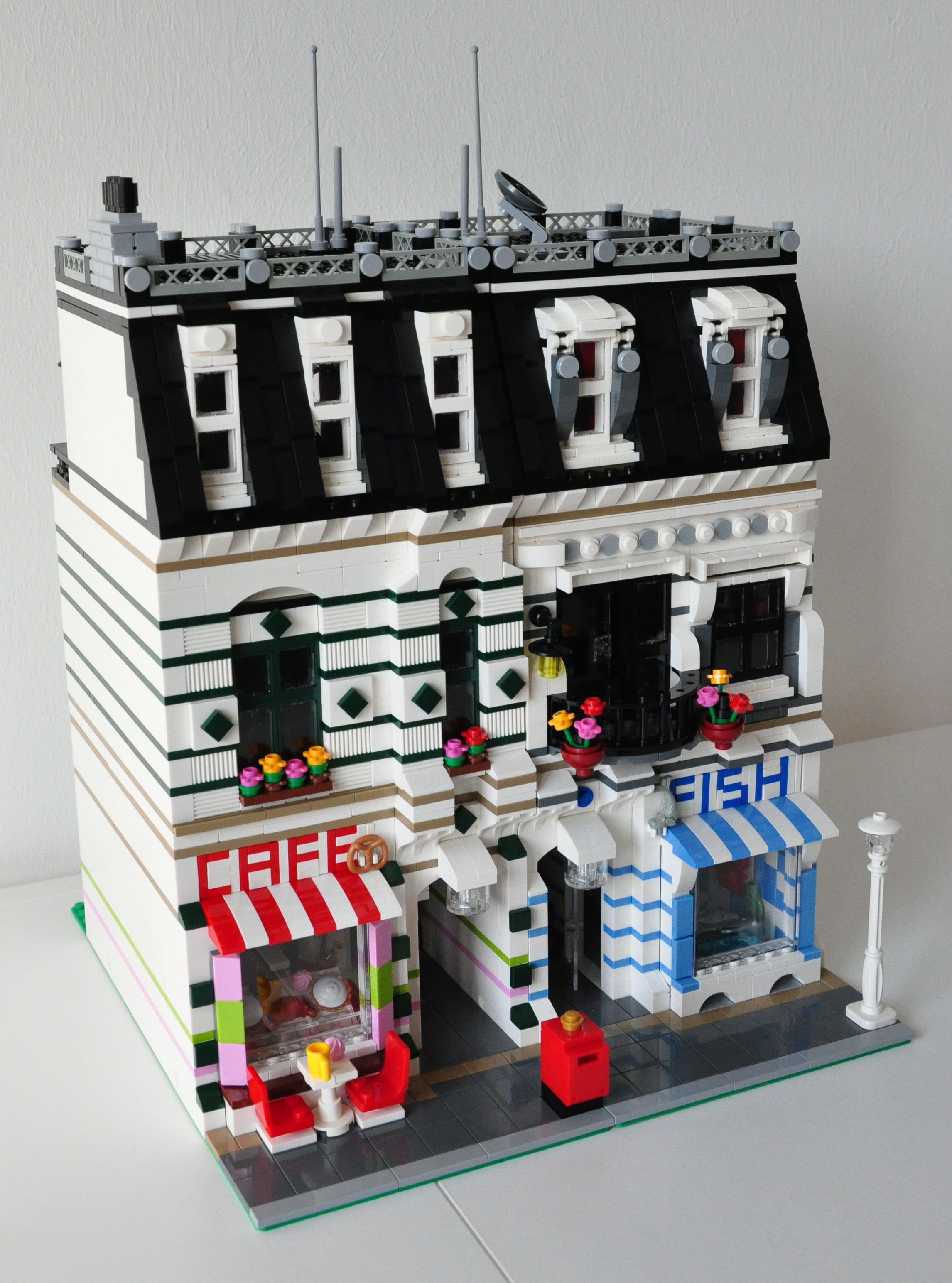

That's one of the better modular mocs I've seen here! I like the roof technique!
Modular Flower Shop by Mestari
